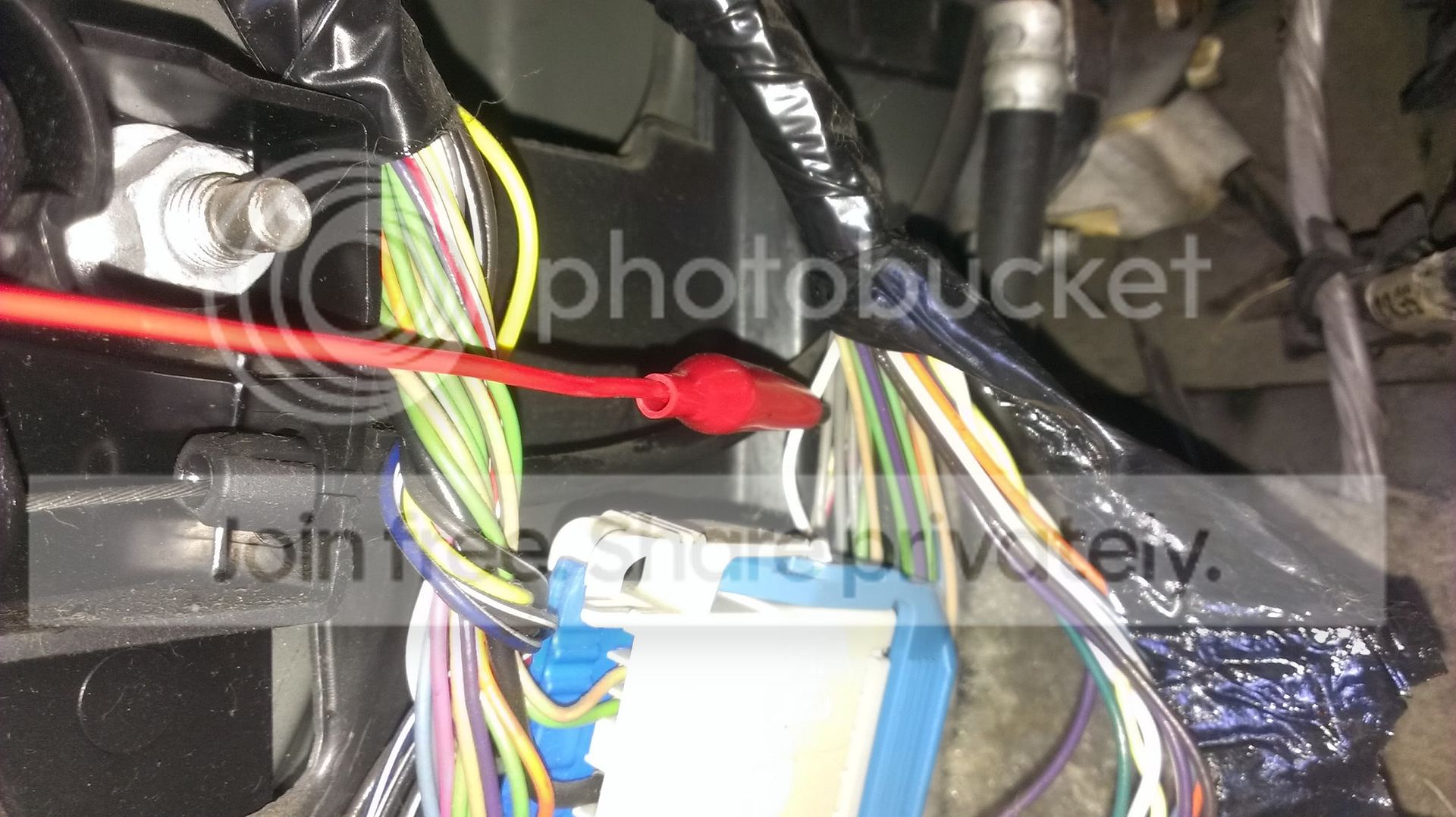

i ran mine to the puddle lights under the mirror so that way the key fob turns them on and they auto off after the lights go off or when you start the truck.
as for the wheel wells i just mounted with the 3m and two self tapper screws to make sure they stay put.
yukonxxl
May 24, 2014
24
Orange Co. Ca
this is the wire I used. your truck should be pre-wired with it. (white wire)
and i mounted the lights inside the fender. no problems. also I soldered all my connections.
