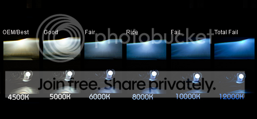

What are color temperatures?
HIDs can be had in a variety of different colors. The color is measured in degrees Kelvin (K). Most HID sellers offer color temperatures ranging from 3000K to 12000K. There are higher Kelvin temperatures out there, but this is the most common range. 3000K HIDs are going to be very yellow/amber in color and are best left for auxiliary/fog lighting. Stock halogen bulbs are around 3200K. Cars that came factory equipped with HIDs, no matter what the make or model, are all in the 4100 – 4300K range. The low 4000K range will give you the whitest possible light with the most useable lumens and most visibility. Higher temperatures will produce a bluer color with less visible light. An 8000K HID bulb will produce about 20% less visible light than a 4300K HID bulb. There is a reason that the OEM HIDs are in the low-4000K range.
I want a white light with a slight tint of blue. What color temperature should I get?
All HIDs in the 4300 – 12000K range are going to produce a shade of blue. Even 4300K will have a slight tint of blue. I recommend staying below 5000K, but that’s not enough blue color for some. 6000K is the happy medium for those who want some visible blue color, yet still have a white light. Higher than that and the lights start to become very blue and are more likely to attract unwanted attention from law enforcement.

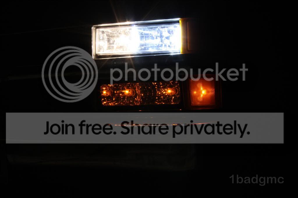

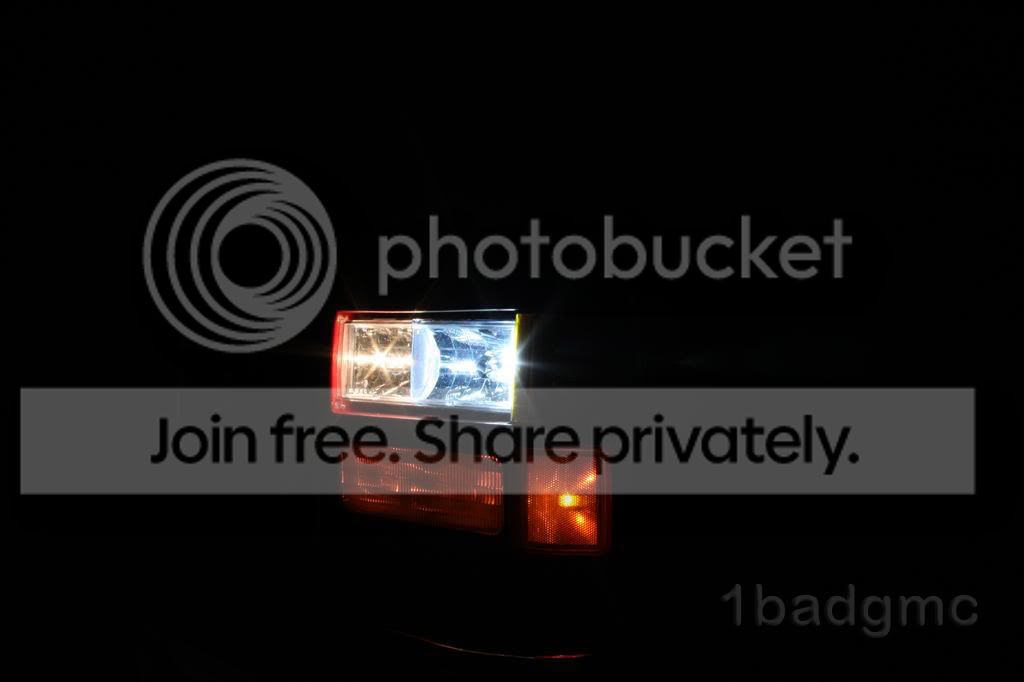

Here are 35w 4500K DDM Tuning HIDs compared with stock halogen highbeams:
These are 35w 5000K HIDgate HIDs compared with stock halogen highbeams:
Notice that even these 2 “white” HID colors are still blue when compared with halogen bulbs.

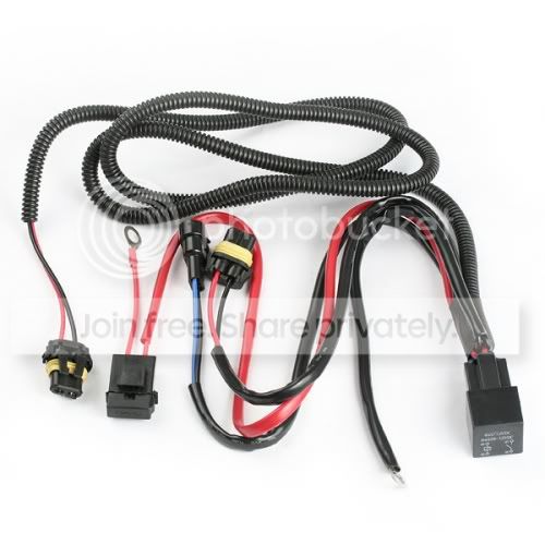

What is a relay harness?
A relay harness (called a dual in/dual out harness on the DDM Tuning site) pulls the power for the HIDs directly from the battery instead of from the vehicle’s wiring harness. Even though HIDs require less power to run than halogens, they do require a considerable amount of power when they are first ignited. A vehicle’s wiring is often not up to the task of handling the power requirements of that initial ignition, which can lead to misfires.
A common symptom is that only one HID will come on. The wiring has enough to handle the ignition of one light, but not both. Usually, the other HID can be ignited by turning the headlights off and then back on again quickly.
Another common symptom is the flickering of the headlights when they’re on. The power flow is not constant enough to keep them steady.
The relay harness will also automatically correct the polarity so you don’t have to worry about which way your ballasts are plugged in.
Do I need a relay harness?
It never hurts to have one. It’s cheap piece of mind. For all GMT-400 OBS trucks and older, I recommend one without question. I have installed HIDs in a ’94 and a ’91 without a harness and didn’t have any issues. I’ve installed HIDs in a ’97 and a ’98 and did have misfires in both. A relay harness on both trucks solved those problems. Even though some trucks may not seem to need one, it would still be best to install one to relieve the strain from the factory wiring and headlight switch.
How do I connect the relay harness?
Most pre-made relay harnesses should have a red positive and black ground ring connector, 2 male headlight connectors and 1 female headlight connector. The harness should look something like this...
Connect the red positive to your battery's positive terminal.
Connect the black negative to a good ground on the truck.
The 2 male headlight connectors will connect to the ballasts.
The 1 female headlight connector will connect to the truck's harness. It's the switched power for the harness.
