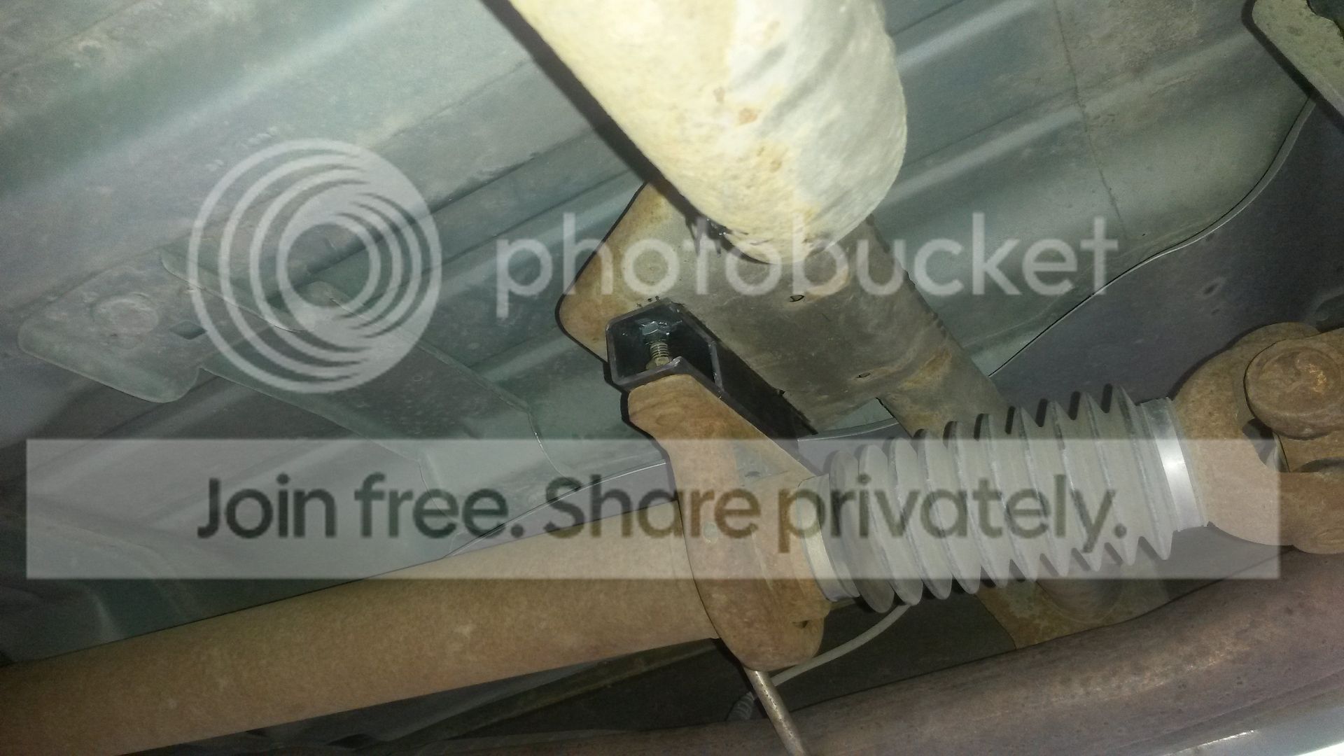

After the lift my timbrens were to far away from the axle to work. So some scrap from work got them back in range.
Also made a carrier bearing drop to straighten out the two piece drive shaft

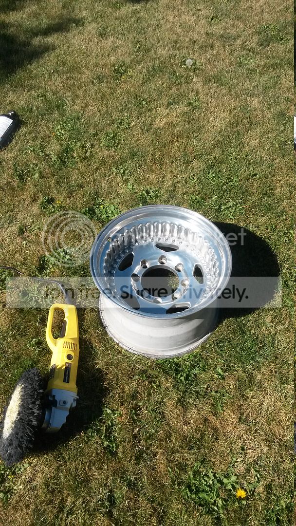

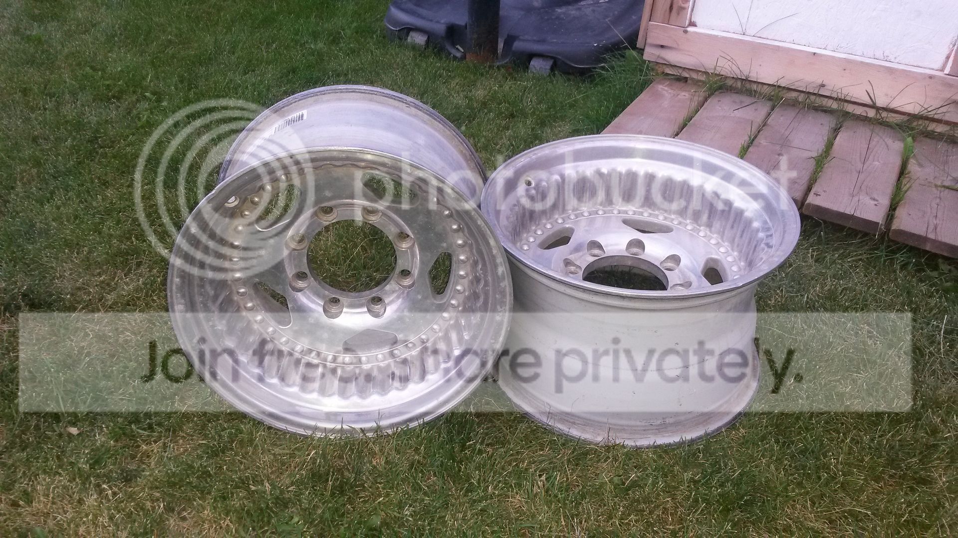

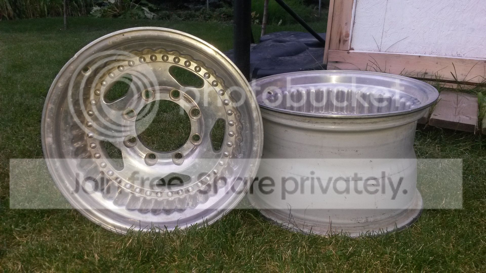

More wheels. Going back down to 16's. During the winter ill put my steel wheels on and try to sell my 20's. Meanwhile polish the crap out of these aluminum wheels and hopefully turn some center caps to fit them as well.
Erki
May 3, 2014
220
9
Alberta, Canada

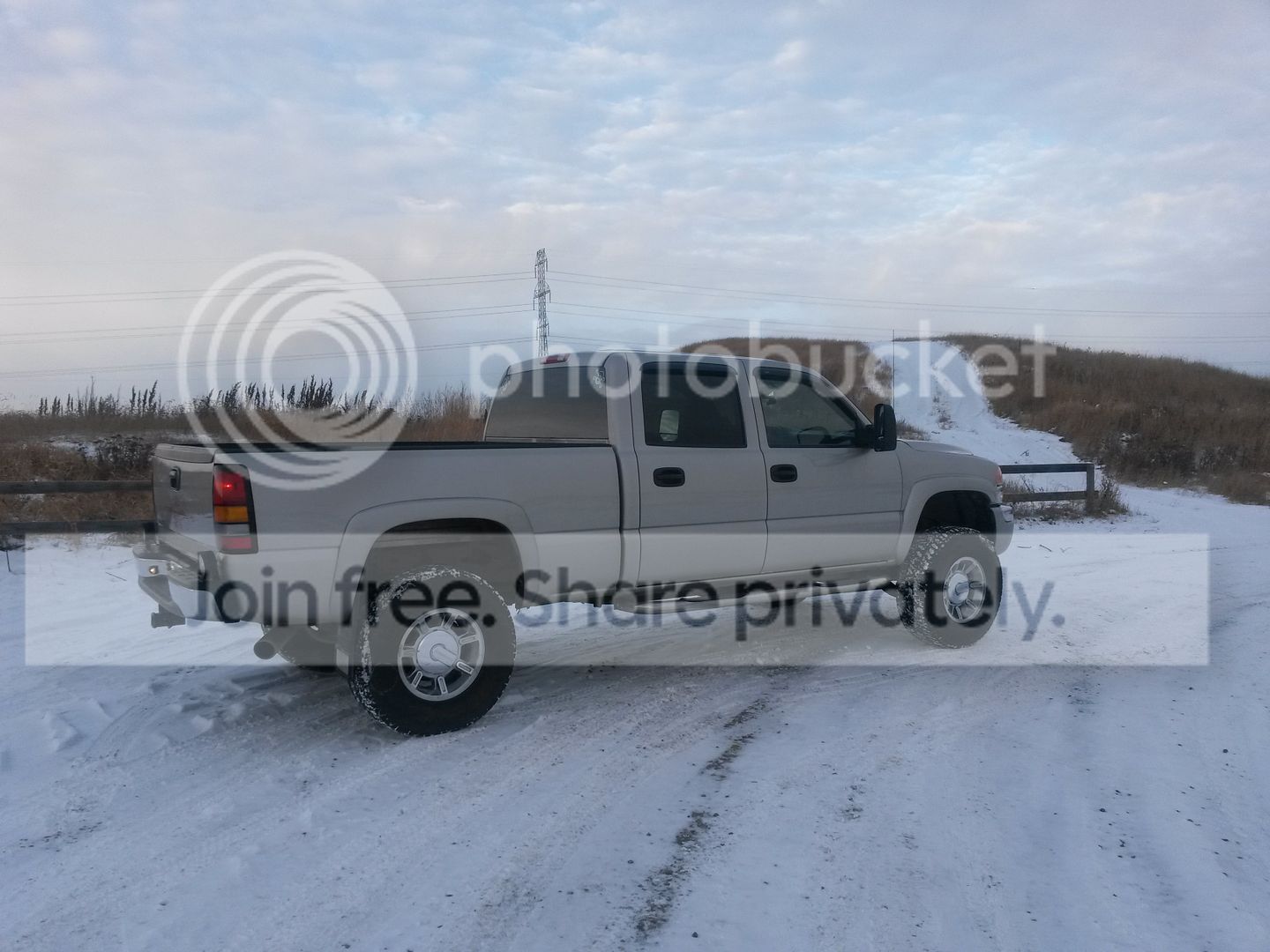

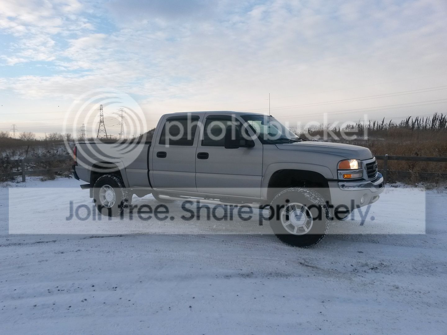

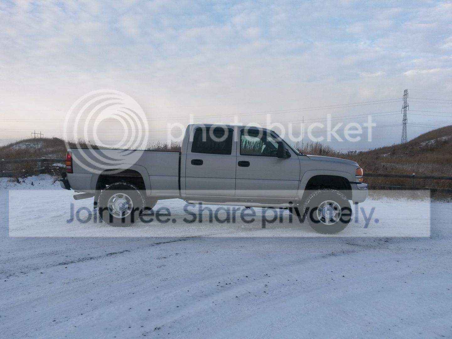

As much as I loved those 16x10s. They were just going to stick out too far for my liking. And if I have to drive through British Columbia I didnt want to give the mounties any reason to pull me over.

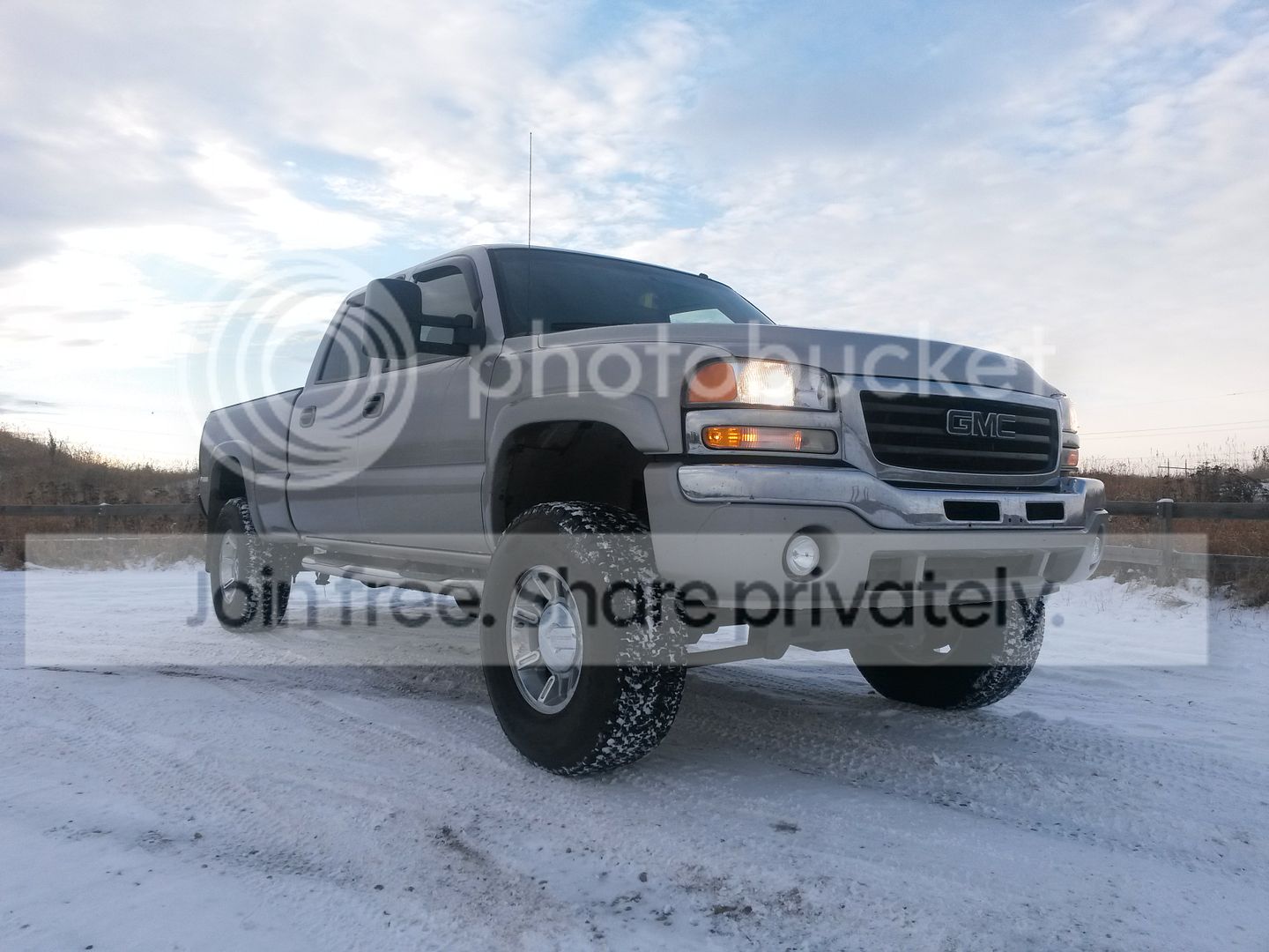

So I sold them and my 20x10s. Picked up these h2 wheels with good tires on them. Mounted them today and really like the look. Tire size is 315/70/17 which calculates a bit over 34" tall.
Erki
May 3, 2014
220
9
Alberta, Canada
Going back to a smaller wheel larger tire combo really helps the ride too. Also load d rated tires aired down a bit helps too. Compared to e rated 20's
